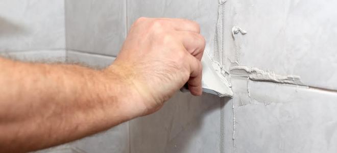

A man works on grout lines.

Floating refers to the process of pressing the grout between the fine lines of a tiled surface and removing any, excess grout. Grouting float has a typical, rectangular shape. The handle is usually made of wood and the flat, pan-like part is made of metal or rubber. The float is used for carrying the grout from the bucket on to the tiled floor.
After applying the grouting mix, it is important to press upon it to ensure that it is inserted into the fine crevices. You need a float for this purpose, too. The flat panel makes it easy to press upon the grouted lines. Due to the compression, the excess grout is squeezed out along the edges. The float is used for swiping and collecting the excess grout.
