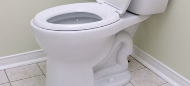

Installing Your Toilet
Pipes required include a cold water supply stub out with a shutoff valve and flexible tubing for above the valve. This is possibly the single, most troublesome fixture to install as it requires its own two-inch minimum vent and a drain of at least three-inches in diameter. If the toilet is situated on a branch drain, it cannot be upstream from the sink or shower. The minimum side distance allowed from the center of the toilet bowl to a wall is 15-inches, and 12-inches from the center of the bowl to a bathtub. Clearance from the front of a bowl to a wall or fixture should be 21-inches.

The closet bend and toilet floor flange must be roughed in first. If you’re replacing a toilet, you need to scrape up the old wax gasket. A putty knife works well for this. Remove the old bolts from the floor flange and scrape the flange clean to prevent leaks at the base of the new bowl. If the old flange is cracked or broken, replace it with a new floor flange.

Using the bolts as guides, lower the bowl into place over the flange. Press down firmly. It is important you feel the toilet being pushed into the wax ring. If you don’t feel this, the flange is set too low and you will not get a good wax seal between the flange and the horn (waste outlet). Also, if the wax ring is cold, it will not properly seat. You may need to warm it in the sun for awhile until it is pliable.
