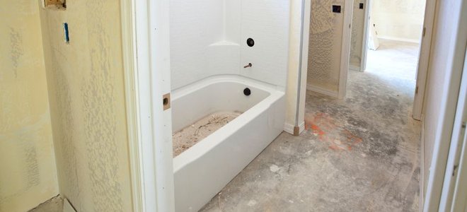

After going over the previous steps from Part 1, your shower/bathtub walls should be ready to go. Now, you’re just several steps away from a fresh new look for your bathroom.
Step 1 – Draw a Plumb Line
Your first job is to establish a vertical reference line you can count on. Use a carpenter's level to draw a plumb line, running up from the outside corners of your bathtub.
Step 2 – Install Corner Panels
The corner pieces are the first pieces of the tub surround to be installed. First, dry fit each one, and if your walls aren't square, adjust the fit by sanding the edges (or trimming, if the walls are really out of square).
The panels are often held in place by both adhesive tape applied by the manufacturer, and additional adhesives applied during installation. Spread a bead of the adhesive around the perimeter of the panel, about an inch in from the tape. Also, run extras beads of adhesive across the back of the panel and around any built-ins (i.e., soap dish).
Remove the paper from the adhesive tape and set the first corner panel in place. Put one side in position and then apply pressure across the panel to the other side. Finally, run your hands over the entire panel, pressing firmly to make sure the glue on the backside adheres to the wall. Install the second corner panel in the same way.
