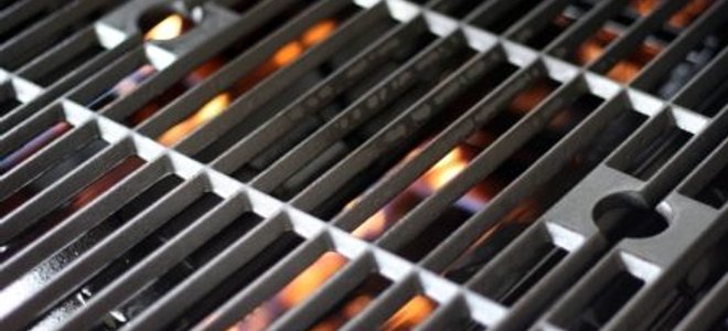

Clean the Grate
Remove the grates. If they’re powder coated steel, clean them with dish soap, rinse them well, and allow them to dry completely.
If they’re cast iron, don’t use any soap or cleanser. Clean the racks with a wire brush and hot water. Allow them to dry completely and then wipe them down use a paper towel with an oil suitable for grilling temperatures such as vegetable oil.
