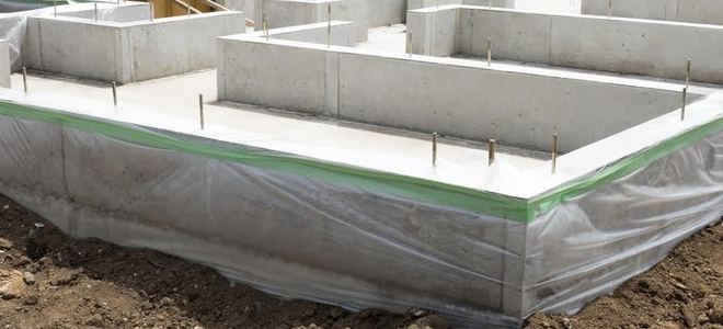

Concrete forming isn’t difficult. It’s important to know the right way to do things, however, to ensure proper concrete forming. There’s a skill in forming concrete, but it’s a skill set that can be quickly learned. Having the right equipment helps everything go smoothly.
Step 1 - Position
Using stakes and string, mark out the position for the concrete slab. Use the level to determine the grade of the concrete. With the tape measure, keep shifting the parallel sides until the diagonals of the slab are equal. Keep the width at the desired distance.
Step 2 - Form
The form is made from boards, which should be placed about 1/8 inch from the string line, held in place by wooden stakes. If the concrete will be 4 inches thick or less, use a 1-inch board. For thicker concrete, go with a thicker board for the form. The timber should be flat and straight with very few knots.
If the slabs will be 4 inches thick or less, the forms can be 32 inches on center. That will ensure that the concrete is properly supported. If the concrete will be thicker, the concrete should never be less than 24 inches on center. The form boards should be nailed to the stakes and put so they’re level to the string line, almost touching it. Pack soil around the stakes to help hold the form in place.
