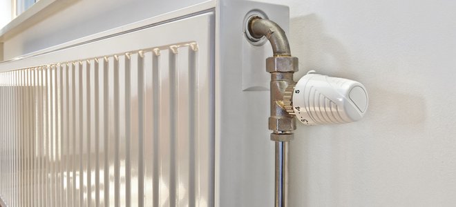

Bleeding the Radiator
When you start bleeding central heating turn the pump and the unit off to prevent the air pump from pushing more air into the system while you operate. Bleeding the radiator on a sealed system can very well effect the systems internal pressure and have to be readjusted after you are done.
The next step, once the unit is off, is to make sure the cold water intake is attached and on to help put back pressure on the radiator which will help to push the air pockets out as you progress. Take your valve key and turn the valve on your radiator until you hear a hissing from the trapped air escaping. Be cautious that if you have just recently turned the unit off that the water that comes out could be hot, and you may want to use a large cloth to turn the key to avoid scalding.
Once water begins to leak from the valve, go ahead and shut it with the same method. Be sure to clean up any water that may drip down to avoid mold growing in the unit. Bleeding central heating can clear air from your lines making your radiator more efficient in your unit, as little things such as this can have a huge impact of cost efficiency of a central heating system.
