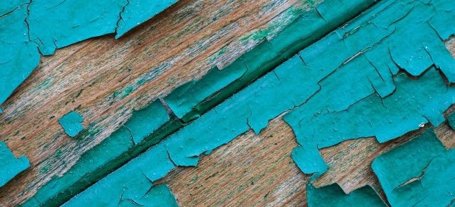

Tip 2 – Removing Peeling or Flaking Paint
On siding that has been painted and where the paint is now blistered or is peeling or flaking, use a hammer to drive popped nails back in place before removing peeling paint. This will make it easier to use your scraper without it getting blocked by protruding nail heads. Then, use your scraper or sander to remove the peeling paint. For paint that is harder to remove, use a heat gun to first heat the paint, then scrape it with a paint scraper. After scraping and removing old peeling paint, use wood putty to fill cracks. To finish, apply primer and paint. If the surface you're cleaning and painting is chalky or faded, you'll be better off repainting the entire surface. Otherwise, you're likely to have paint colors that don't match.
