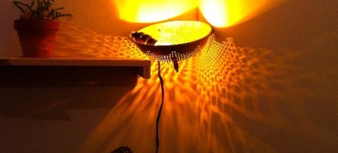

The colander light is an easy way to add an interesting light source to any room. It is ridiculously simple to create, but variations on the idea are endless and your creativity is what will make the piece shine. By simply placing a lightbulb in a colander, intricate light patterns cascade over your walls and ceiling. This simple piece adds a creative flair to previous designs, leaving plenty of room for customizing the idea to fit your lifestyle.
I use this as a bedside light, screwed in the corner just above my bed; a soft yellow bulb is diffused by the colander creating the perfect light for reading or drawing. It also makes a convenient place to put your glasses, earrings, or any other things that might get taken to bed.

Step back and take a look, this is what you should see: The colander is screwed into the corner (or wall), the light fixture is sitting in the colander, and the chord is draped behind the colander in the space created by the corner. Now switch it on and enjoy,
