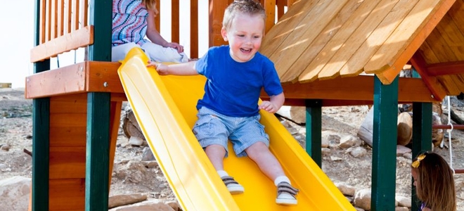

Building a playground slide in your backyard is a challenging activity as you have to ensure the children are safe when using the slide. It is also best to consider the age of your child, as large slides (those more than six feet in length) are not suitable for toddlers. You need to build a slide that is safe for your children to use.
Keep in mind that a reasonable amount of construction and carpentry skills are needed in the process. You will also need to purchase a plastic slide that comes with the necessary hardware to safely install it onto your deck.
