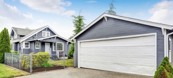

Building A Garage Part 4 - Laying the Wall
A garage.
