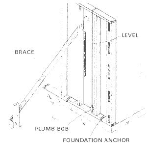

 The Garage Door Framing 6. Lift the wall into place and have one person hold a long 4-8' carpenter's level against the inside or outside of the wall until it is positioned plumb. A plumb bob can also be, used.
7. Then nail 2" x 4" braces from the top of the wall into stakes driven into the ground outside the wall. The braces should be placed every 10 to 12 feet.
8. Beginning at one end of the wall, bend the sill anchors over the bottom sill plate and nail them to the sill plate with the nails provide.
