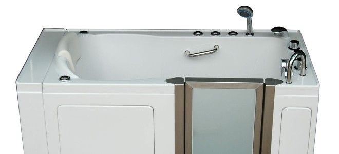

To make your bathroom more accessible for a disabled or elderly person, consider adding a bathtub with a door. The door seals tightly, preventing water from spilling out, while still allowing easy movement and a safer method for entering the tub. Though existing bathtubs can be modified, the process is far more difficult than installing a new customized bathtub.
