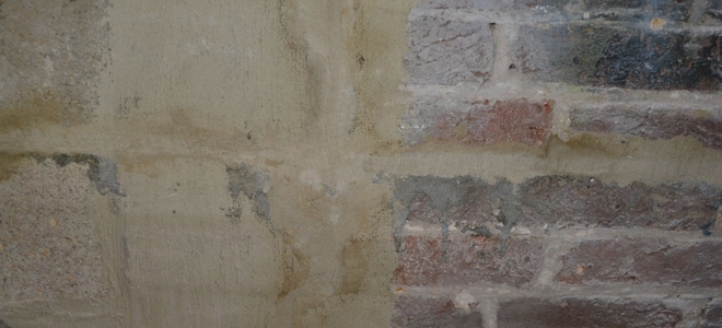

Step 3 - Mix your Mortar and Start Your Course
bucket of mortar next to a brick wall
Only mix enough mortar to last you approximately 1-1 ½ hours. The cement mix will become unusable after that. Using the chalk line that you snapped as a guide, begin laying your first course. Be sure not to overuse the mortar mix, and use a level to make sure your course is staying level as you go along. This is very important in making sure that your brick garden wall remains level in all areas.
