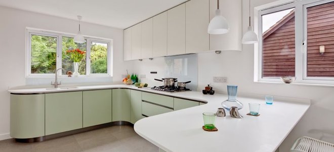

Kitchen with white laminate countertops and green cabinets
