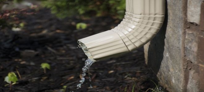

If you are in an area that gets a lot of rainfall you may need a drywell. A drywell is used to collect water that drains from your gutters. The following steps will teach you how to build your own.
Step 1 - Understand Where to Put the Drywell
The chief reason you want a drywell is to stop water from collecting in your yard or around the foundation. Choose an area that is away from the home and one that is preferably on a slight downward slope. Make sure the drywell location is in direct sight and centered to the downspout.

Step 4 - Adjust the Downspout
Since the downspout is already on an angle you need to bend it so the opening is straight toward the trench. Place a section of solid PVC pipe inside the downspout. Attach the PVC joint to that piece of pipe so when you add on another piece of pipe it will follow along the trench.
