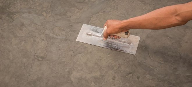

Someone hand troweling a concrete surface.

Pour the Concrete
Concrete should be poured in whole sections and it cannot be dropped or poured from a height greater than three or four feet, or segregation will occur. Concrete should be spread evenly throughout the forms and should be rodded manually or vibrated mechanically to remove any trapped air. The slab is poured to a depth of four to six inches over a plastic moisture barrier sheet, and a fibrous expansion joint is installed where the edge of the slab meets the foundation wall. It is important to level the top of the foundation wall at the proper height.
Let it Cure
During the curing process, concrete should not be allowed to become too hot (above 80 degrees) or too cold (below freezing) and should be kept damp or moistened or it can crack. The concrete will attain its final set in about a week, and reach its designed strength in 28 days. After a week the forms can be stripped from the foundation, and the boards and studs can be cleaned and reused if they are removed undamaged.
