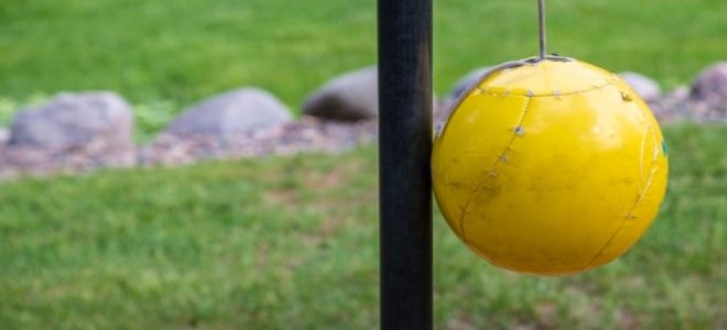

A game of tetherball is a popular activity that people of all ages can enjoy. While these game areas are normally found on playgrounds, homeowners can easily set up their own. The tools and equipment are relatively inexpensive for this DIY installation, and you don’t need much outdoor space. Here's a brief guide on how to build a tetherball set for your backyard.

Place the base of the tetherball pole into the cement in the bottom of the hole before it has a chance to set. Use a level (minimum four-foot) to ensure that the pole is mounted straight. Pour in the remaining cement to bring the hole up to ground level, being careful not to overfill. It’s easier to place dirt, gravel, or grass over top of the cement, but any raised bump will be difficult to flatten once the cement has hardened. Use wooden braces to ensure the pole stays in a straight position while the cement sets overnight.
Step 6—Complete the Tetherball Area
Lastly, attach the tetherball and rope to the top of the pole using the mounting clip. Make sure that the rope is as long or as short as you'd like so that it doesn't drag the ball on the ground or hit any other items in the area. Figure out the diameter needed for the play area and level out the ground around the pole to that distance.
