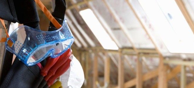

Roof dormers light up the interior and add living space in the attic. When turning the attic into a bedroom or other living quarters, it is important to build at least two roof dormers for ventilation and to reduce humidity. There are various styles of roof dormers, from arched to polygonal, and you can choose depending on the design needed.
Step 1 - Map the Design
Illustrate the design on a paper to estimate the size of the roof dormers and to help you in estimating the cost of your project. Visit a supplies store with the draft to get the required amount of supplies.
Step 2 - Put Your Illustration on Visible Ground
Draw the window plan on the attic floor close to where you want to make the opening. The diagram should be plumb. Insert a nail on each of the corners of the roof with the measurements you made. Make the outline of the sides using a plumb bob to direct you, and draw straight lines using a chalk. If the cut will touch the rafters, hammer a 2ft by 4ft support on the top and bottom that will be in place until you attach the new rafters on the recessed roof.
