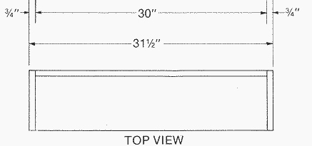

Step 1- Cut the Wood to Size
For your towel rack, you will need to cut two sides, two shelves, and backs for the shelves. Cut the wood using a table saw and a stop block. Follow the measurements in the diagram. Measure from the rip fence to the inside of the saw.
towel rack diagram

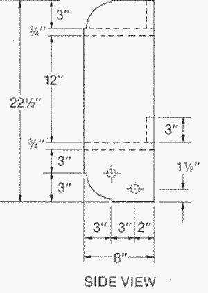

Step 3 - Cut the Curve
Before you cut the curve, measure and mark the wood how you want it to look. Use a band saw or a jig saw. Cut two straight marks first. Then cut the curve, moving slowly. Repeat this process on both ends.
towel rack diagram
Step 4 - Drill the Holes for the Towel Rods
Look at your plans for hole locations. Mark them with a pencil. Use a drill to make the holes. You can make a depth gauge with a piece of tape wrapped around the bit to make sure you are not drilling too deep.
towel rack diagram

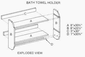

Step 5 - Assemble the Bathroom Rack
Before you begin to assemble the rack, sand all the pieces you have just cut. You wouldn’t want to get a splinter! Line the pieces up to make sure they are all the right size. Then, you can start applying wood glue to the edges and rod ends. Use clamps to hold it while it is drying. While it is drying, apply finishing nails. Sand the rack and then apply a finishing product.
