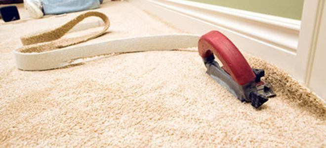

Whether you’re a professional carpet layer or a do-it-yourselfer, you'll find one of the trickier aspects of laying carpet is connecting each carpet seam. Seams that are not connected correctly can look unprofessional, can cause the carpet to split or unravel, and can create a potential hazard for those walking on it.
If you are considering laying your own carpet, there are a few problems you will want to avoid to make the carpet seams virtually invisible. The following information will assist you in avoiding carpet seam mistakes when laying your carpet.

To avoid the splitting of your carpet seam, keep the seam away from areas of higher foot traffic. Use a pad with a higher density cushion that is less likely to split from constant foot traffic. In addition, when creating seams, use a seam roller to create pressure against the seams and force the carpet backing into the melted adhesive. Finally, create a more firm, flat base for the backing by placing a piece of plywood under the seam when you press the seam into the glue.

To avoid creating unattractive seams with wrinkles, indentations, etc., always use a sharp blade and change it often when cutting for a seam. Never cut across a tuft row. Always cut along the space between rows. Pre-stretch seam areas that can otherwise cause wrinkling. Avoid using rollers with star wheels that can create indentations when you use hot adhesive. Instead, disburse hot adhesive evenly into plush carpet backing by using a roller with a smooth surface. A good rule of thumb to remember is star rollers for cold seams, smooth rollers for hot seams.
