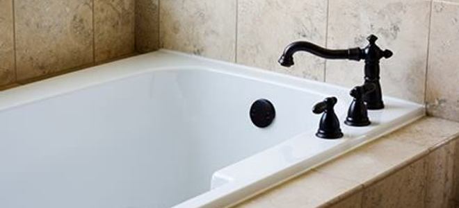

Re-Caulk a Tub or Faucet
An improper seal on your tub and faucet is not only unsightly, but can allow water to seep behind your fixtures and tile, damaging the wall, decreasing tile stability, and creating a breeding ground for mold!

• Using the razor scraper, carefully scrape away the old caulking. Hold the scraper at an angle so as not to damage the tub or faucet surface (a). Score the caulk with a utility knife to break the seal if the caulk is diffi cult to remove (b).
• Make sure to scrape away all caulk and mineral-deposit residue.
• If there is considerable caulk residue that you’re having trouble removing with the razor scraper, try a caulkremover product. Wipe it on and let it soak in according to the manufacturer’s directions. (Note: If the old caulking is silicone based, this product won’t work. I recommend good, old elbow grease because the chemicals needed to break down silicone are highly toxic and nasty.)
• Wash the entire area with a disinfectant cleaner and let it dry thoroughly.
• Fill the tub with water and work in the tub barefooted so that the weight pulls the tub down and fully opens the joint. Just don’t splash around as you work.
THE PROJECT
1 Cut open the caulking tube at an angle, and pierce the seal inside the nozzle with the caulking gun’s provided piercer or the tip of a wire hanger if your gun doesn’t come with one.
2 Load the gun and push forward on the plunger of the gun until it hits the back of the tube.
 3 Put the nozzle of the gun on one side of the sink or faucet and begin squeezing the trigger.
4 As the caulk fl ows out, drag the tip of the gun along the edge of the sink or faucet. Do this until one side has a continuous bead of caulking.
5 Release the plunger (so it doesn’t continue to push out caulking) and put the gun down.
6 Wet the tip of your fi nger with a few drops of baby oil. Run your finger gently over the caulking, smoothing out the bead.
7 As excess caulking accumulates on your fi nger, wipe it on a rag or paper towel and continue along the bead.
8 Repeat Steps 3–7 until all sides are complete, and then let the caulking dry thoroughly.
