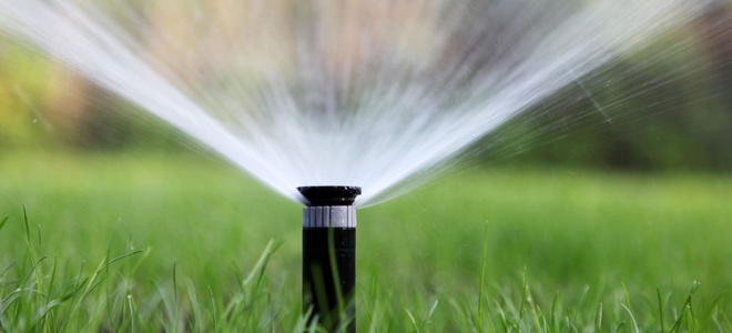

Cleaning sprinkler heads can prevent problems like clogging, which can affect the way your lawn or garden gets watered. Clean your sprinkler heads at least once a year, but also check them frequently for clogging and dirt build-up so you can tackle any problems before they arise.
