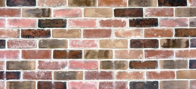

Multi-colored brick wall

Faux brick siding can be a great way to provide the appearance of an exposed brick wall in your home without having to support the weight and cost of real brick. However, whether your faux brick siding is inside or outside of your home, sometimes your renovation and redesign plans call for a change in your walls. In these cases, you may find removing the faux brick siding will provide you with a suitable appearance for the space. Fortunately, removing faux brick siding is easier than removing a real brick wall.

faux brick wall
Depending upon how many brick faces are attached in one brick tile on your faux brick siding, you may need to either continue by chipping away at the surrounding mortar or by using the pry bar. If it's easier to split up the brick faces in the faux brick siding, you can do this by using the larger masonry chisel. Continue until you're able to remove the first chunk of brick from the wall.
