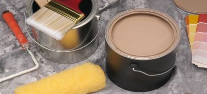

Great Paint Jobs are Made with the Right Paint Applicators
Paint Applicators
When we’re painting, most of us just want the paint on the wall as quickly as possible with minimal mess. I have found that using the right tool for the job makes it easier and, with the proper tool in your hand, watching the paint move from the bucket and onto your walls and trim can even be enjoyable.
Here is an assessment of the key tools and the circumstances in which you would utilize each one.
