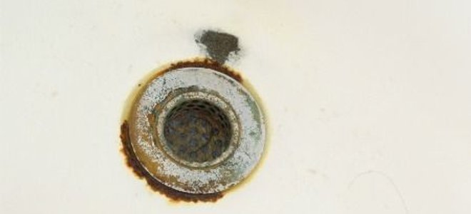

An old sink drain with rust around the metal fitting.
