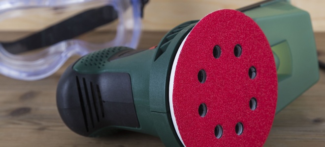

Adhesive and Manual Mounted Discs
assortment of sanding discs
There are sanding discs that have a simple peel off adhesive strip, and those that you have to glue to the rubber glue pad on the sander spindle. The two types have their benefits and downfalls. The adhesive type pads seem to make the changing of sanding discs easier, but they may come loose or rip if not given the proper amount of time to bind before use. On manual glued types of sanding discs, if you apply too much glue they will not stick properly and bend or warp from the moisture that's applied to them. You can add glue to a self adhesive type sanding disc if you want to add the extra bond. It is good in either case to let it set and dry for about 10 to 15 minutes before using them to avoid causing problems.
