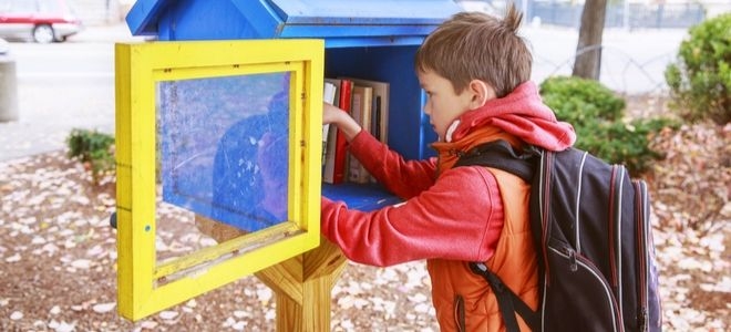

a child reaching into a little book library
