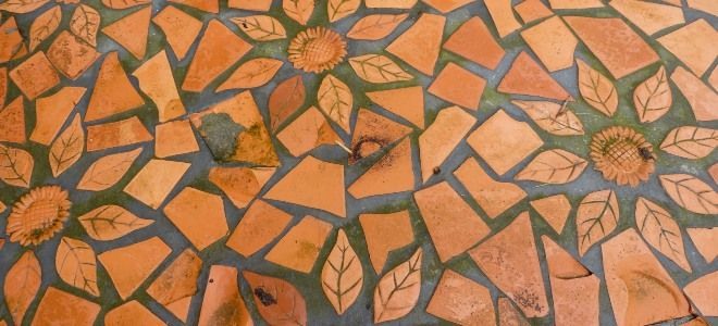

assortment of leaf print tiles
Select a flat work surface, and place the plywood sheet face-down. Attach tiles along the length of the plywood using water construction adhesive. The edge of the plywood sheet and the edge of the tiles must be flush with no space left for grouting. Leave a four-inch gap at the center of the plywood sheets. Allow the adhesive to dry.
