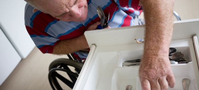

Cabinets
With your varying heights of countertop, your cabinets will most likely need to be custom-made. Tell your carpenter that you will need space under the sink and under the cooktop that is at least 30” wide by 27” high by 19” deep. This will give anyone in a wheel chair (or a regular chair) the ability to work in these areas without having to stand.
A drawer in a kitchen with plates.
Think about using all drawers in the lower cabinets, and make sure they have full extension glides. Having drawers instead of cabinet doors allows for easier access. Choose easy-to-grasp handles as well. A typical cabinet is 18 inches from the top of the countertop. Request that they be installed 15 inches from the top of the finished countertop. This allows for 3 inches of extra useable and reachable space. If all drawers aren’t your thing, how about lower shelves with pull-out baskets?
