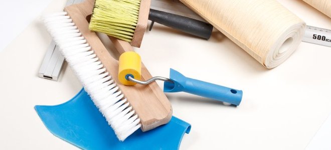

Wallpapering tools
  • 3-8 hours
  • 100-300
Wallpaper tools
