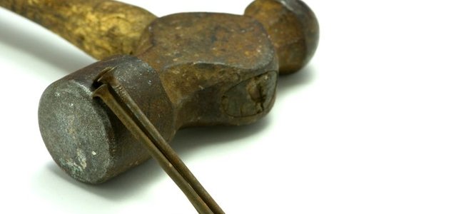

Cross Peen Hammer: 7 Blacksmithing Tips
Peen hammer
