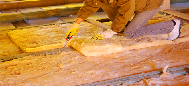

Measure
Use a measuring tape to measure the width and the length of the joist or space where the batt insulation will be installed. Make a note of the measurements to ensure the proper size before you begin cutting.
Cut
Insulation and tools
Before beginning this project, put on protective clothing, gloves, goggles, and mask to protect yourself from irritation and inhalation of harmful fibers.
Layout the insulation paper-side up on a hard and level surface. If working on a finished surface use a piece of plywood underneath to protect it from getting nicks and cuts.
Use your knee or a heavy object to secure the insulation before you begin cutting.
Once the proper measurements are marked on the batt insulation, use a knife such as the popular Olfa knife, with a fresh sharp, and long blade, long enough to make a clean cut through the thickness of the insulation.
Cut the insulation using short steady strokes utilizing a metal ruler or carpenter’s square as a guide as you cut along the length.
Apply pressure to the ruler or carpenter’s square as you cut to condense the insulation for easier cutting.
Give a few inches of allowance on either side of the batt insulation to ensure proper fit and allow for any discrepancies in measurements. Any excess insulation can be easily tucked in to fit, preventing gaps between the studs and the insulation.
