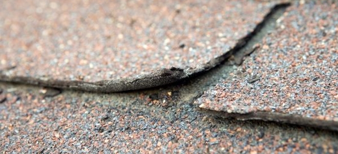

Step 2 — Locate the Problem Shingle
Find the shingle you need to replace.

Step 5 — Remove the Damaged Shingle
Use the pry bar to push up the nails on the damaged shingle. Press it down and pull the nails out using the hammer in the same way you did on the previous shingle. If part of the damaged tile comes detached, you may need to pull out one or more of the nails still in the roof with just your hammer.
Step 6 — Place New Asphalt Shingle
With the damaged piece now loose, you can remove the damaged asphalt shingle and slide your new shingle into place, tucking the top underneath the shingle immediately above it.
Using the hammer, nail down the new shingle with eight nails, trying to get as close to the original positioning as you can.
