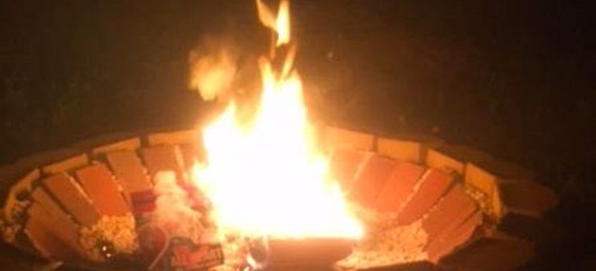

Step 2 – Determine the Size
Because the Tennessee soil where this was built is made up mostly of hard clay and large rocks, less digging was ideal. So, a combination of an in-ground and a built-up pit was used.
The depth was determined by the size of the brick, and the brick size was chosen based on price. As it turns out, the cheapest brick was 8 inches long by 4 inches wide. Therefore, the hole was dug just a little more than half the length of the brick: 5 inches deep.
You can choose your brick to coincide with the look and size you are going for, just make sure to recalculate your measurements of your DIY fire pit. For example, you may want a longer brick for a deeper hole, or to have them sit against the rocks around the rim.
A 4-foot-wide diameter was the perfect size to accommodate about five to six people. The goal is to have something big enough for a nice-sized fire and to have enough room for your guests to sit comfortably around your DIY fire pit on a crisp summer night. At the same time, you also do not want it to overpower the rest of your yard or be so big that you cannot control the fire.

Step 5 – Lay the Bricks
lay bricks for diy fire pit
Make sure the base of your hole is fairly level, especially around the edge where you will be placing your bricks. Instead of having the brick come up and above the rim to meet where the edging will be laid, these bricks were placed at an angle to give it a slope. They do not have to be flush against each other, but you want them to be relatively close. The closer they are, the less pea gravel you will need for filler.
Step 6 – Pour the Pea Gravel
The pea gravel makes for a nice filler to fill in the gaps and keep the bricks from falling over. Pour the gravel in and maneuver it between the bricks. You will have to go around the circumference and lift the bricks, pouring in the gravel (and sand) behind them. You want to press the bricks back in and really pack them in so that they are secure.
Remember to save some of the filler for the rim.

Step 8 – Finish it off
Pea gravel isn’t the prettiest. Once you’re done with the basic functional design, consider adding some river pebbles to the center of the pit. The river pebbles are more aesthetically pleasing than functional, but they do help build up the center nicely. If you are using them, just pour in about half a bag in the center and spread them out a little throughout the center. You can also use them around the outside of your DIY fire pit.
diy fire pit
Now you are all set to roast some marshmallows and have that camping experience in your own backyard.
