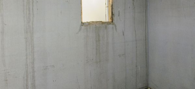

Step 2 – Inspect the Space
Examine your entire basement for any moisture issues or cracks in the concrete.
Examine your entire basement for any moisture issues or cracks in the concrete. You don’t want to start an insulation project only to find there are more severe issues with your foundation. If you detect any problems, contact a certified contractor and schedule an appointment to have your basement assessed.
