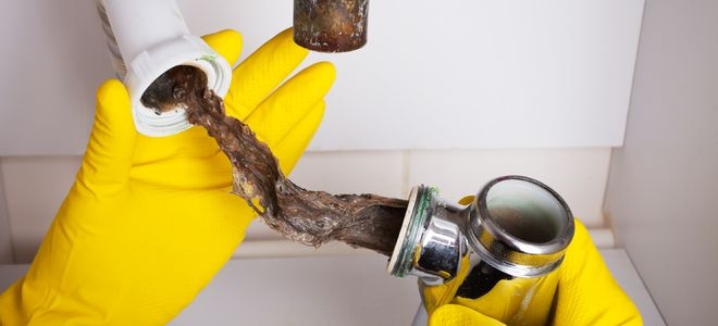

Clean Your Sink’s P-Trap
The p-trap mechanism of your kitchen sink may need to be cleaned to clear a clog. This is the curve of the drainpipe under the sink, usually in the cabinet underneath the sink. Before doing this, place a bucket or pan to catch any water under the curved pipe. Dislodge the p-trap from the drainpipe and manually clear out anything that is stuck. Replace the mechanism, then run the water to detect whether this measure worked in fixing the drain.
