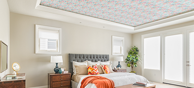

You’ve probably heard of a statement wall, but what about a statement ceiling? Whether this phenomenon is new to you or an already familiar idea, statement ceilings are an undoubted decor trend for 2019.
Characterized by a bold characteristicwhether it be a color, accents, material, or patternthese ceilings have a way of bringing a room together and making an eye-catching statement. Below, learn how to create your own statement ceiling to create the wow factor in a room that you’ve been craving!
Wallpaper Statement Ceiling
Some may think of wallpaper as a decor thing of the past, but the truth of the matter is that wallpaper still has a respectable place in the world of home design. With many alluring patterns, colors, and materials on the market today, it’s easierand more funthan ever to use wallpaper in your home. Conveniently, wallpaper makes for the perfect method of creating a statement ceiling in order to be a part of this design trend. The steps to hanging wallpaper along the top of a room are below, and they’re more straightforward than you may think!
