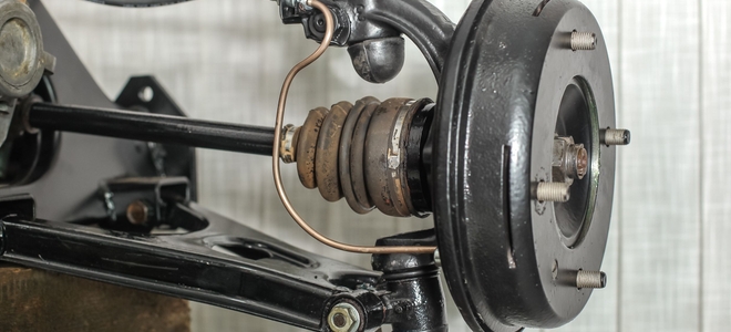

1. Check the Ball Joint for Looseness
Close up of ball joint in a car
This can be accomplished by wiggling the tire to see if it moves and by sticking a pry bar under to see if it is loose. If it is loose then you will need to replace it. Double check once you get the car jacked up. It can be hard to tell when the car is on the ground.
