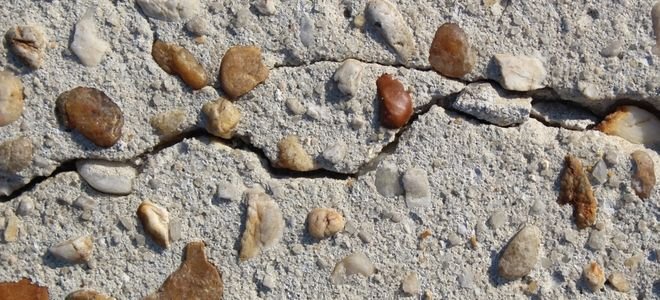

Drilling, nailing, and screwing into concrete can be challenging tasks that require precision and care. Despite concrete's appearance of toughness, it is surprisingly brittle and prone to cracking. To avoid concrete cracks, it's crucial to understand how to execute these tasks properly. In this article, we'll explore step-by-step techniques for drilling, screwing, and nailing into concrete while minimizing the risk of cracks.
Drilling into Concrete
When drilling into concrete, it's essential to use a hammer drill rather than a regular drill. Additionally, opt for a carbide-tipped drill bit, which stays sharp during the job, unlike regular drill bits that quickly become dull. Here's a step-by-step guide:
Choose the Right Equipment
Use a hammer drill and a carbide-tipped drill bit for clean and efficient drilling. Regular drill bits become dull quickly and can lead to cracks, so stick to carbide-tipped ones.
Position the Drill
Hold the drill perpendicular to the surface you're drilling and apply light pressure, letting the bit do the work.
Proper Technique
Allow the bit to bounce off the bottom of the hole, breaking up the concrete and providing a surface for better grip. Avoid forcing the drill, as excessive pressure can increase the risk of concrete cracks.
Hold the drill perpendicular to the surface being drilled to prevent undue pressure on the concrete.
Let the drill bit do the work, applying light pressure without forcing it.
Measure Depth
Determine the required depth for the anchor or bolt you'll insert into the concrete. Mark that depth on the drill bit using masking tape and stop drilling when you reach it. Drilling deeper than necessary can weaken the concrete and lead to cracks.
