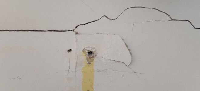

A crack and hole in drywall that needs to be repaired.
If the drywall in your house is damaged in a few places, it's an easy DIY task to patch it yourself—provided you have the right tools and this handy guide! Depending on the size of the repair, patching drywall is a fairly simple process, and we detail the steps below depending on the size of the hole you're patching.
