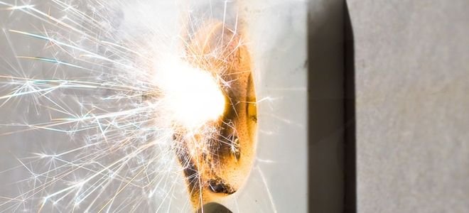

If you have an electrical receptacle in an outlet that is making buzzing noises or is sparking, you should correct the problem immediately in order to prevent the possibility of an electrical fire. Although correcting these type of problems in receptacles is a rather easy process, it is one that should not be delayed. With that in mind, this article will address some of the primary causes of buzzing, arcing and sparking in an outlet receptacle and how to identify the problem.
