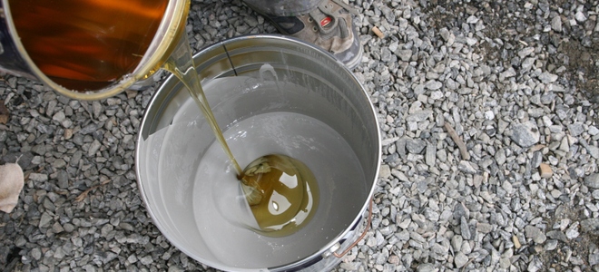

Epoxy cement repair is a procedure in which epoxy (a polymer) is added to cement when cement repairs are undertaken so as to increase the strength and anti-stain properties of the cement. If you follow these directions and instructions carefully, you will find that you save a lot of money, effort and time when it comes to cement repair. In addition to that, the end result will be neat and the amount of waste produced will be minimized. You will be satisfied and the need for another repair job will be eliminated.

The first thing that needs to be done is making a thick paste by mixing cement with water. Water should be applied to the hairline crack in order to moisten it for at least 4 hours before the paste is added. It is important to ensure that the surface is dry before the mixture is applied with a pointing trowel. Make sure that you apply enough force to force the mixture into the crack. The surface should then be leveled and evened out. This area should be left to dry for 2 hours after which a plastic sheet should be used to cover it. The plastic sheet should be lifted and water should be sprinkled for five days after which it should be removed.
