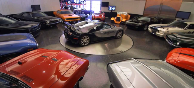

Epoxy Garage Floor: What You Should Know
An epoxy garage floor.

Turn that oily, dirty concrete slab in your garage into a shiny, clean showroom floor by adding an epoxy garage floor that will enhance the overall appearance of your garage. You and your car will feel as if you're driving into a showroom every time you open your garage door.
An epoxy garage floor will make your garage look as if it's brand new, but it also resists oil stains, beads of water, and wipes clean like a kitchen counter when dirty. Your garage floor will always look sparkling clean and stay attractive for years.
