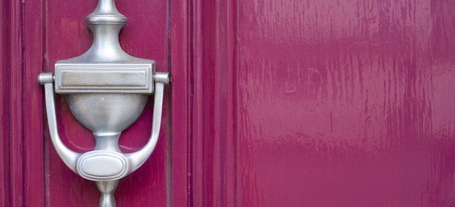

Properly maintained exterior wood doors make a beautiful addition to any home, increasing both aesthetic and market appeal.
Performing an inspection of all six sides of the door at least once a year can help keep these doors in tip-top shape for the lifetime of a home. The maintenance procedure is basically the same whether the door has been painted or coated with a clear, natural finish.
