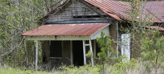

A tin roof is very useful because of its durability, strength, and robustness. Usually, tin roofs are the preferred type of roofing for patios, or as an extension to the current roof. This type of roof is also popular for tool sheds and many other outdoor structures. However, as useful and long-lasting as they may be, even tin roofs are subject to wear and tear. A worn-out roof can cause a lot of problems, especially if it is raining. Here are some simple steps to help fix a leaky roof.

Usually, tin roofs are not that high because they are not part of the main roof, so you can easily locate the leak by standing on a ladder. However, if you do have to climb onto the roof, ensure you are wearing shoes, the safety gloves and make sure you do not step on any loose part of the roofing. Leaks are usually holes in the roof or corroded and bent areas.
