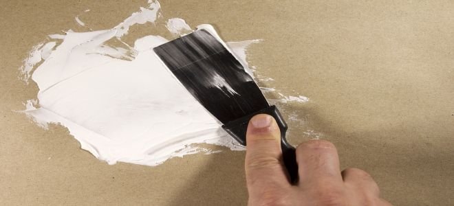

Take the piece of wood, set it flat against the wall and wrap the string around it. Tie it tightly and this will hold the tin can lid in place. Use the putty knife to spread drywall patching compound over the tin can lid. Do not fill the hole with putty just yet. Once you have about 2/3 of the depth of the hole filled, allow it to fully dry before finishing.

Home improvement stores now sell instant drywall patch kits that consist of a square of sheet metal (available in various sizes) covered by self-adhesive drywall tape. This patch takes only two minutes to apply. Just clean the area around the hole, peel off the backing and stick the patch right over the hole in the wall. Cover the area with spackle or joint compound, wait for it to dry, sand, and repeat until smooth.
