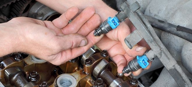

The injectors on a flex fuel motor are designed for the use of gasoline and gasoline mixtures. In flex fuel motors, a mixture of 85 percent ethanol can be used in place of gasoline. These mixtures are environmentally friendly, but they can also leave vapor deposits that need to be cleaned. A dirty injector can not inject fuel where it needs to go at the right rate. This service should be conducted annually.
