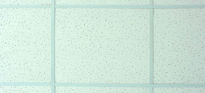

A close-up of some suspended ceiling panels.
