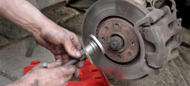

Step 4 - Remove Calipers
Use your socket wrench and take the caliper off of the brake pad and rotor. Do not suspend the caliper with the brake line only. This can cause the line to break, or leaks to form. Hold it with a short piece of string or a bungee cord.
Step 5 - Sand Brake Pads
Once the caliper is free of the rotor you can pry out the brake pads. Sometimes rust will accumulate on the edges of the brake pad and cause the caliper to stick. Once you have the pad in your hands, use some 500 grit sandpaper and sand off any rust, or dirt. Sand it down until you see bare metal on the pad. Place them back in the brake caliper after you have finished.
Step 6 - Clean Pins in Caliper
caliper clip and pin
A simple pin located in the caliper can become dirty with grease and cause the whole assembly to stick. Use some anti-seize fluid on the pins and place them back into position.
Step 7 - Replace Calipers
Compress the calipers with a clamp and place it back onto the rotor.
