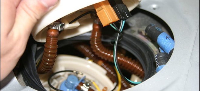

Removing an In-Tank Fuel Pump
If your car has an in-tank fuel pump, you won’t need to raise the back end of the vehicle because you can remove it from the inside of the vehicle.
To do this, you first need to discover where the access point is. It will either be under the back seat of your car or under the carpeting in the trunk.
An in-tank fuel pump will be connected to the fuel lines at the top and bottom of the pump. Using the wrenches, disconnect the fuel line. Make sure that a container is in place to catch any leakage.
Disconnecting the Wiring
The final step in fuel pump removal is to disconnect the wiring. Two wires will be attached to the fuel pump, regardless of whether it’s located under the car or in the tank. One of the wires will be positive and the other negative. Note which is which so you’ll be able to re-connect them properly. They will be held on by small bolts or, in some instances, by screws. Loosen and remove the bolts and take out the fuel pump. This completes the fuel pump removal.
